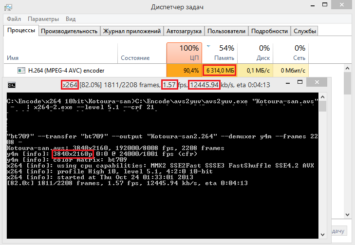

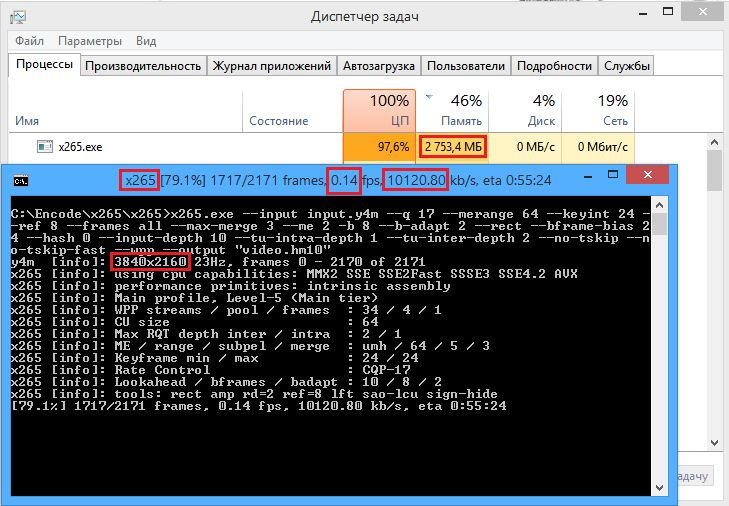

    r479 finished the 360crop test without crashes. So I took the chance to run it with the FullHD version too.
    x265.exe sintel_trailer_1080.y4m -o sintel_trailer_1080.hevc -F 3 -q 20 -b 3 --b-adapt 2 --bframe-bias 30 -w --ref 3 -i 240 --psnr --ssim --rdpenalty 1 --csv sintel_trailer_1080.csv
    Great quality at "-q 20". Because I didn't trust the log about "Global SSIM: 0.995", I made a RawSource+Subtract().Levels() script to emphasize the differences. Result: It is probably true. Differences are minimal.
    And despite Shazeb Khan's opinion that
    weighted prediction (--weightp) is yet not ready to work with frameparallelism (-F 3)
    (from the developer mailinglist), I spotted no data corruption artefacts.

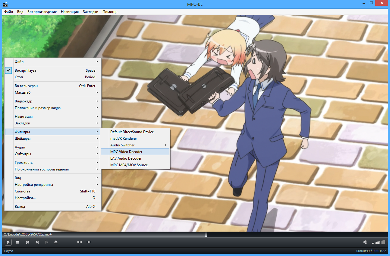

  9. Very well played by MPC BE. Even madvr works.
    Coded slice. And shows a container with any sound.

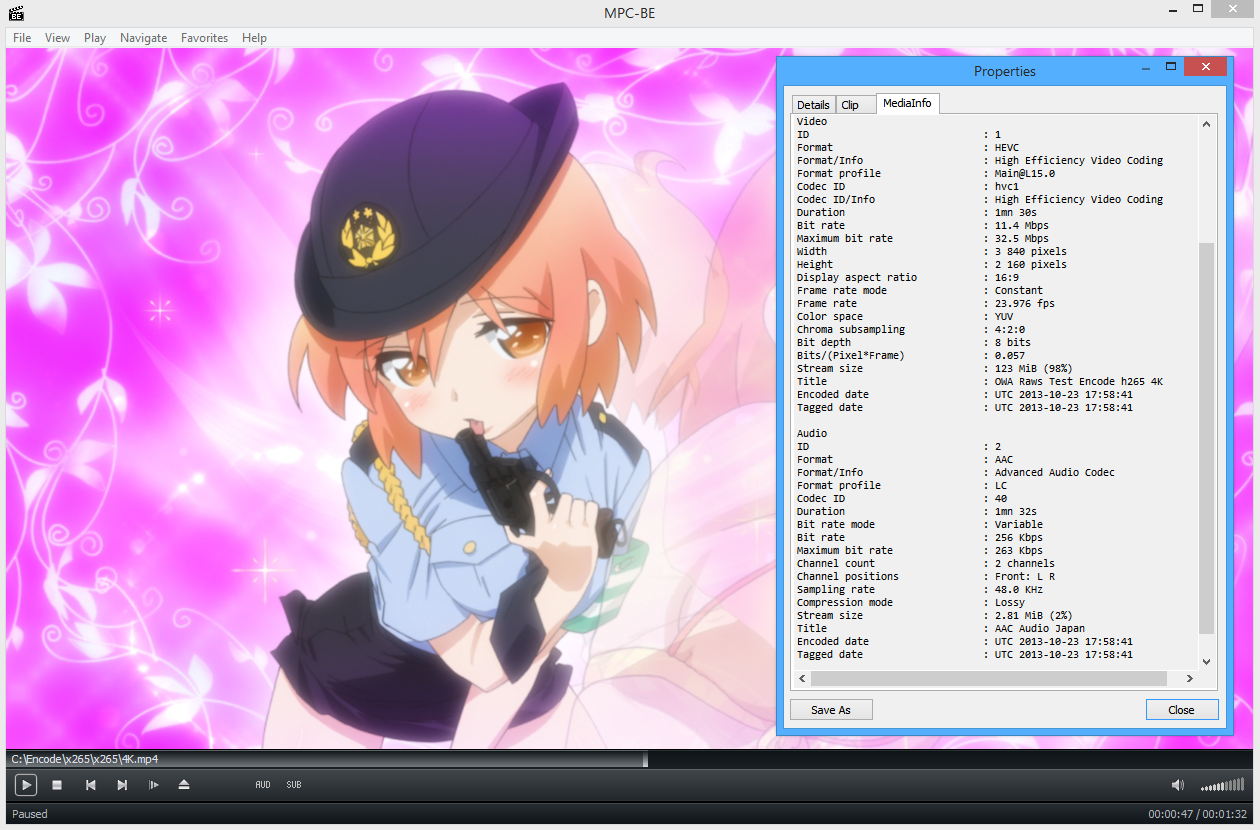

  11. Encode 4K
    Video
    Format : HEVC
    Format/Info : High Efficiency Video Coding
    Format profile : Main@L15.0
    Codec ID : hvc1
    Codec ID/Info : High Efficiency Video Coding
    Duration : 1mn 30s
    Bit rate : 11.4 Mbps
    Maximum bit rate : 32.5 Mbps
    Width : 3 840 pixels
    Height : 2 160 pixels
    Display aspect ratio : 16:9
    Frame rate mode : Constant
    Frame rate : 23.976 fps
    Color space : YUV
    Chroma subsampling : 4:2:0
    Bit depth : 8 bits
    Bits/(Pixel*Frame) : 0.057
    Stream size : 123 MiB (98%)
    Title : OWA Raws Test Encode h265 4K
    Encoded date : UTC 2013-10-23 17:58:41
    Tagged date : UTC 2013-10-23 17:58:41
    Audio
    Format : AAC
    Format profile : LC
    Codec ID : 40
    Duration : 1mn 32s
    Bit rate mode : Variable
    Bit rate : 256 Kbps
    Maximum bit rate : 263 Kbps
    Channel count : 2 channels
    Sampling rate : 48.0 KHz
    Compression mode : Lossy
    Stream size : 2.81 MiB (2%)
    Title : AAC Audio Japan

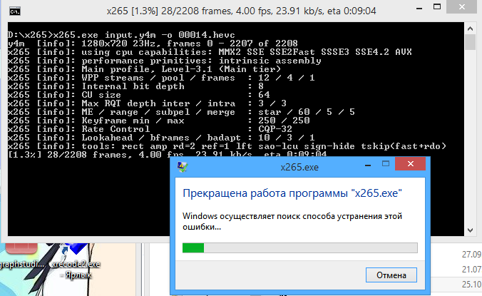

  27. I am all that there is builds used. Falls right at the start, time to encode 10-15 frames after Windows severs process.
